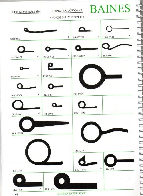

Posted - 18 Feb 2015 :  17:35:32  Show Profile  Reply with Quote
I have their full catalogue at home & will try to remember to have a look at the weekend for those numbers: just as a second line of enquiry

Posted - 21 Feb 2015 :  14:31:44  Show Profile  Reply with Quote

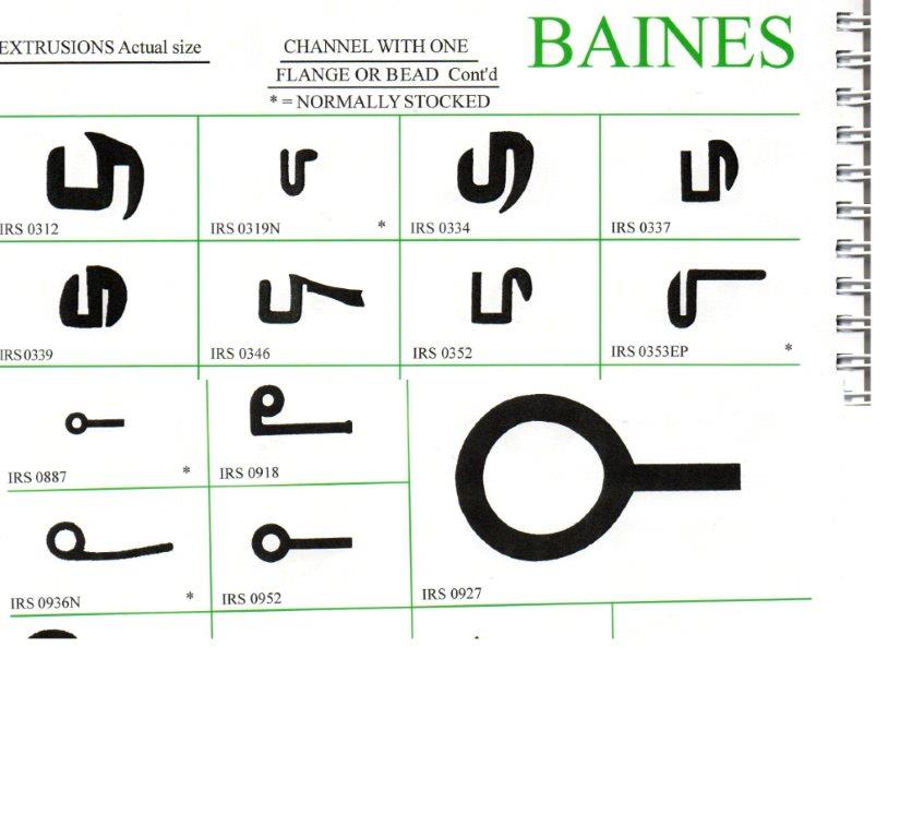

Found them both in the catalogue (7th edition): both references say they are 'normally stocked'. I cut the header off of the second one, but it comes under 'Hollow Piping'.

Hi Glen,
Thank you very much for your help and now I see the slight little mistake John has made with the number of the second rubber.
It must be IRS 0936N instead of IRS 0963N. The "3" and the "6" were switched! So now I am able to order this rubbers with Baines.
Thanks again!

pruyter
Netherlands
325 Posts
Posted - 21 Feb 2015 :  16:16:01  Show Profile  Reply with Quote
Oeps....I have checked the website of Baines and I am really amazed!
Two days ago I found on their website IRS 0353EP and today I can't find this rubber. Secondly: I searched in the section "Hollow Pipes" and....I found IRS 0963N, the number John mentioned, but I can't find IRS 0936N the rubbers which is showed in the cataloque of Glen. Both numbers look much alike and the same thing is with the drawnings of this rubbers, although I see a slight difference.
So now I really don't know what to do! One thing maybe helps and that is if John can provide me with the right numbers on the invoice of Baines and perhaps if John has someting written down in the cataloque.
If you both guys or somebody else has some idea I will much appreciate this.
Best regards,
Peter
Posted - 21 Feb 2015 :  18:38:02  Show Profile  Reply with Quote
Oops. I think I've added to the confusion. I should not have chopped off the 2nd page. Here it is in full, showing both 936 & 963. I think the latter is indeed correct. For the channel; 353 is definitely correct.
Sorry again for confusion: 963 looks to be the bigger version of 936.
Regards. G.
