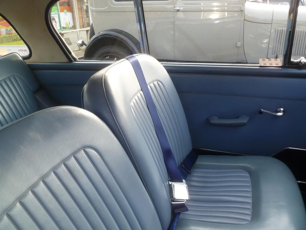

Recently purchased series 3 Rapier, would like to fit seat belts, any advice as to best to fit would be appreciated. Would the car have been designed with anchor points.

Hi DHR... (you may have to weld some metal plate to act as a support. I believe our car had that modification already in place...)
I have a Series V Rapier and we have successfully fitted retracting seat belts to the front seats.
I will look out the spec of where we bought them if you like ... they work perfectly and do not look out of place as they are colour co-ordinated to the carpet...
there is some of of special attachment which fits just above the elbow rest each side of the rear bench seat.. and the belts retract back there...
I will try to find a photo which might help...

Having trouble attaching photos of my seat-belt mechanism
will review things and try again later..
The supplier was Quickfit Safety Belt Service 0208 206 0101

Posted - 20 Nov 2013 :  08:48:43  Show Profile  Reply with Quote
hope these photos help
