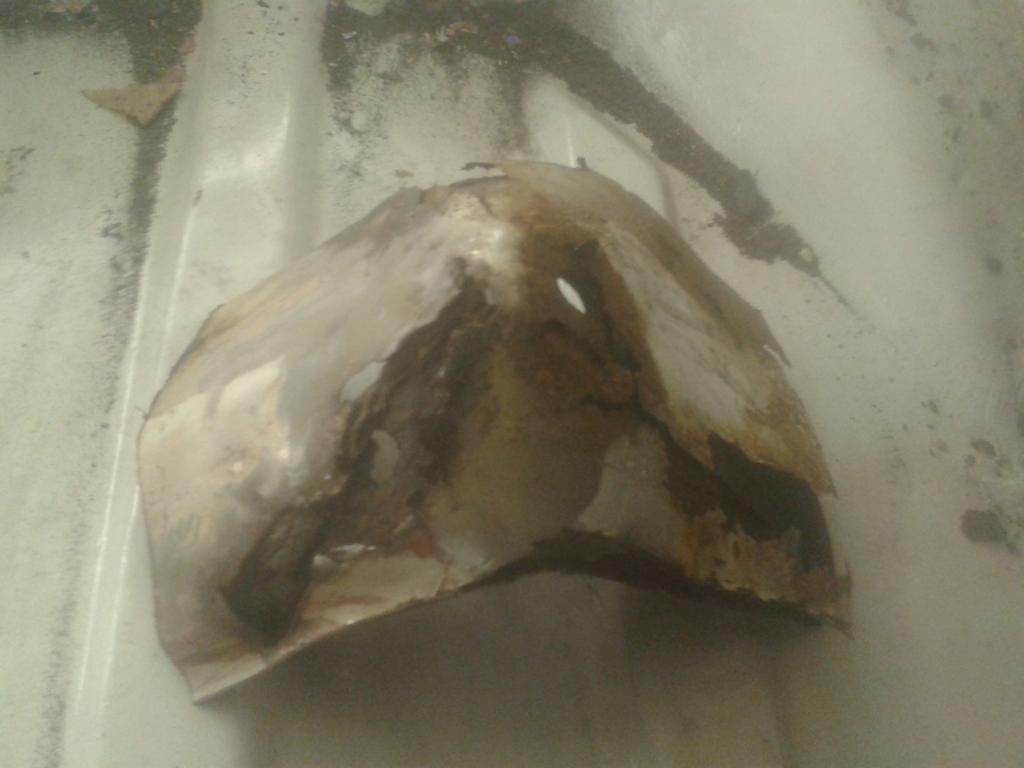

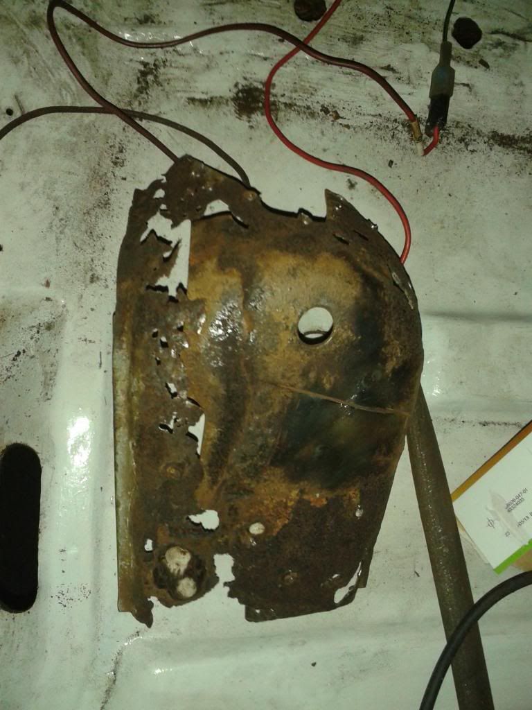

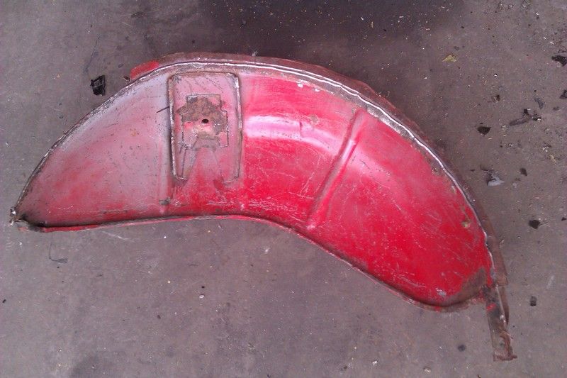

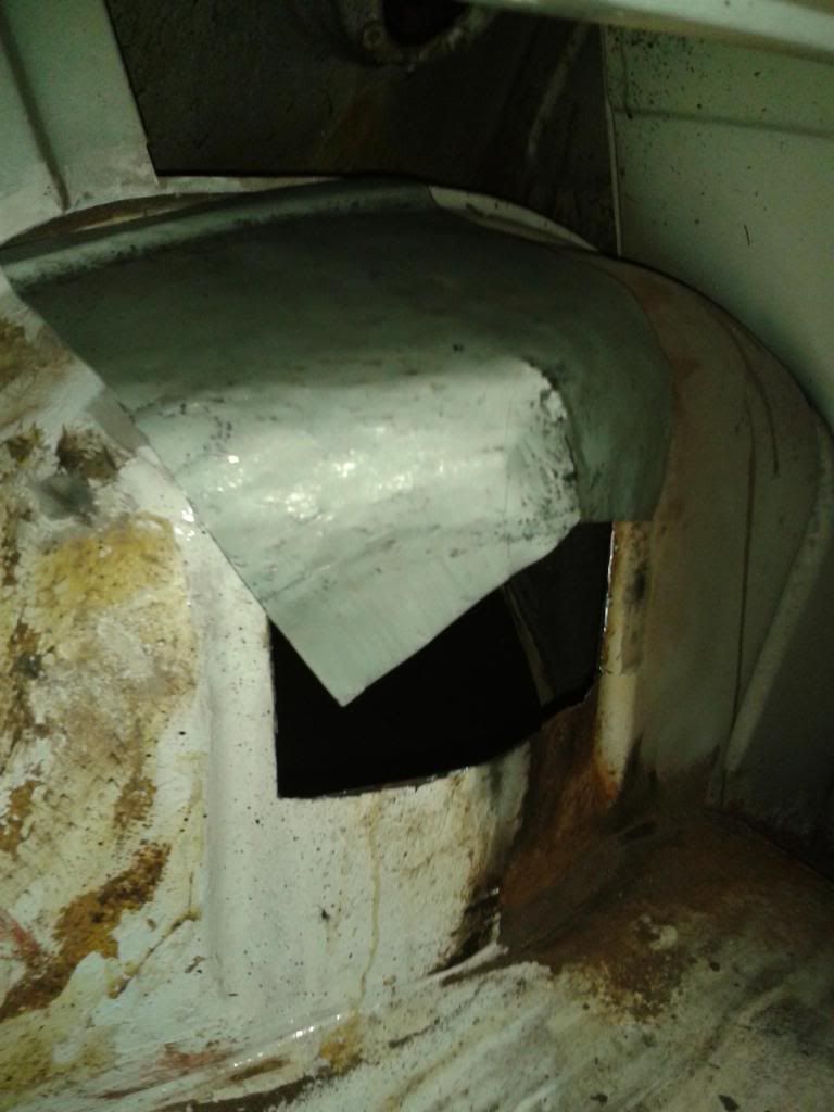

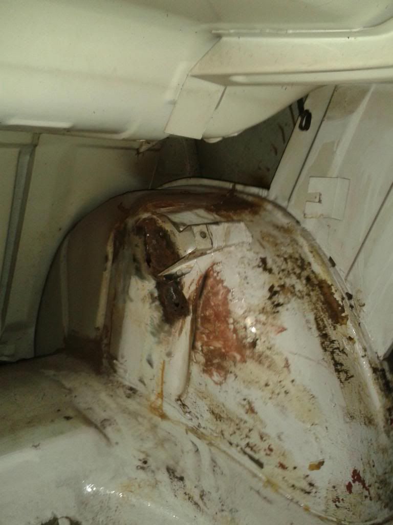

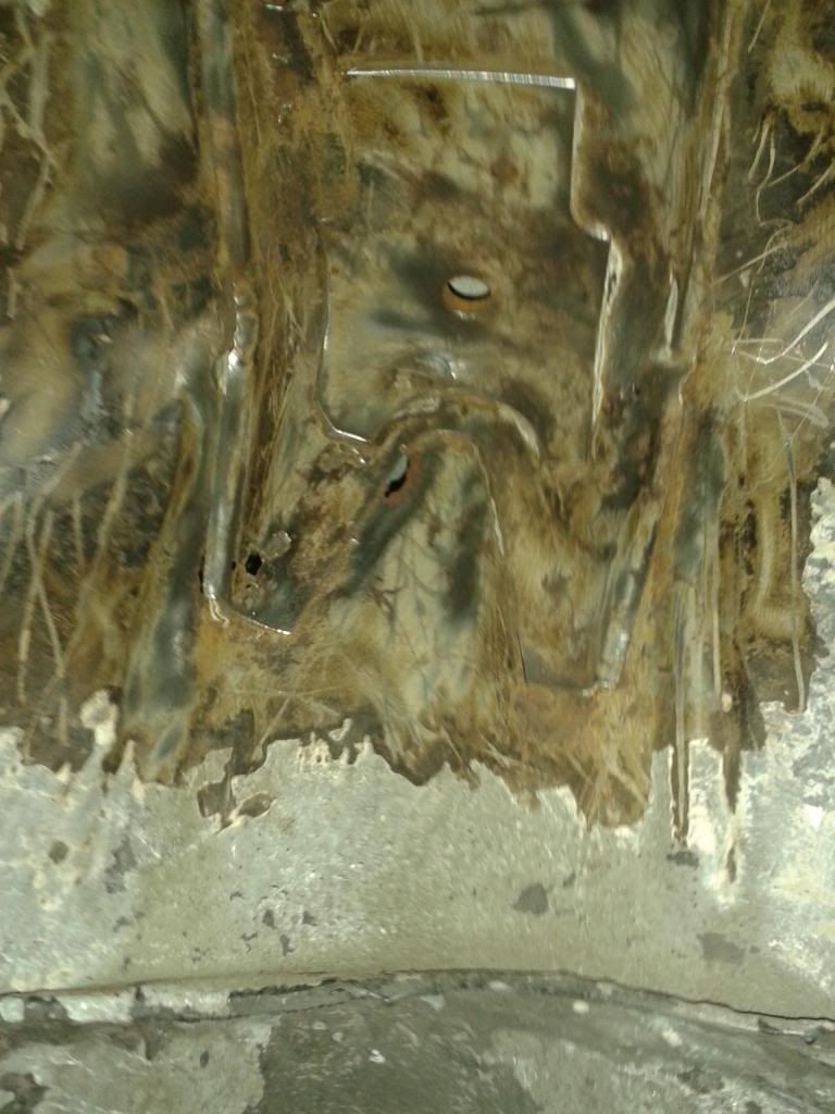

Posted - 04 Feb 2014 :  21:55:19  Show Profile  Reply with Quote
Since there's probably not going to be an easy solution soon,
I've started fabricating my own repair panel..
Here's what was left...
RH-side
LH-side (all ready cut out)
Here 's what I've got so far...

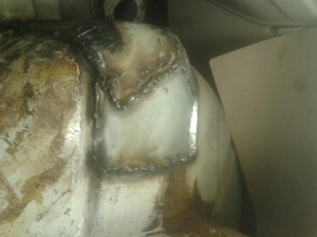

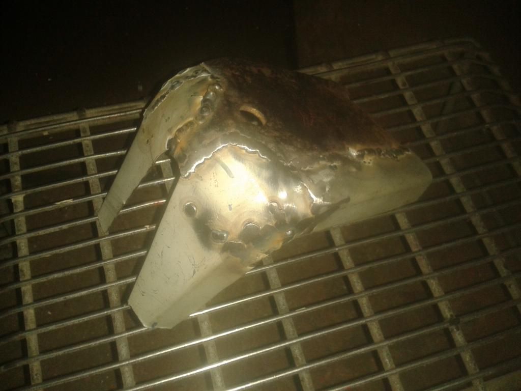

Posted - 19 Jul 2014 :  12:39:51  Show Profile  Reply with Quote
Sorry for this I had to do it quick that day so will take my time to upload a couple as soon as possible..

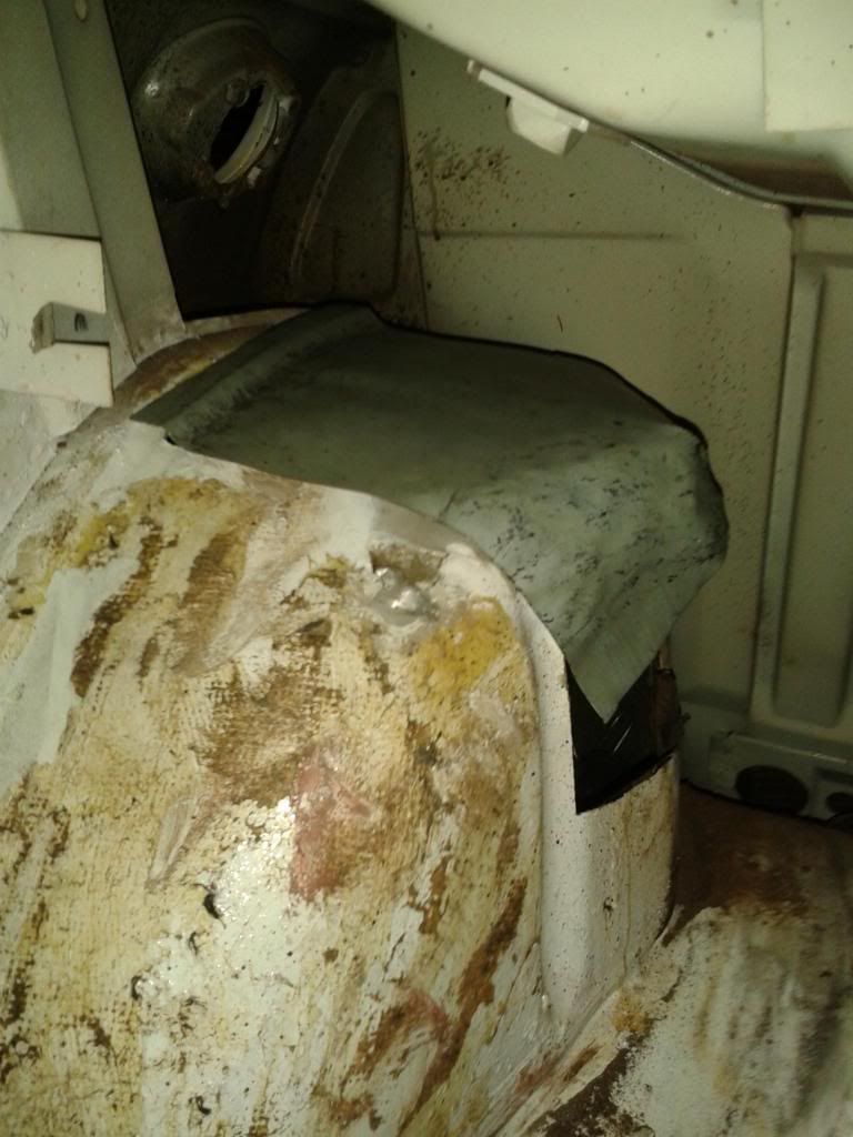

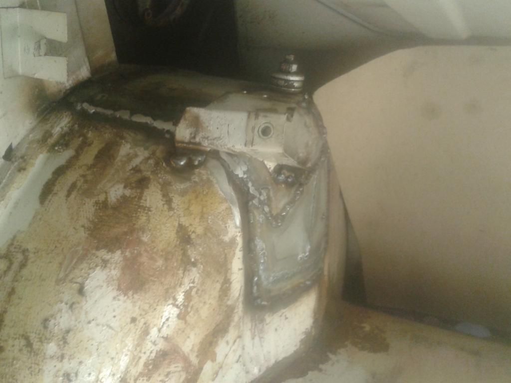

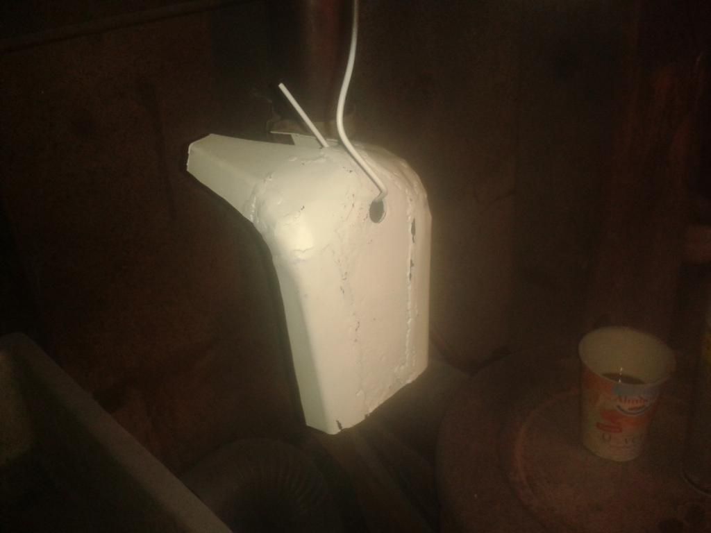

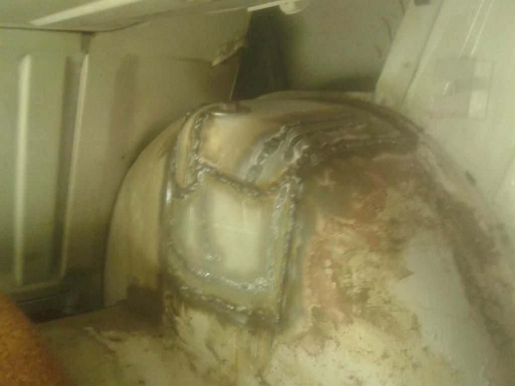

As you all know both sides were really bad..
So I cut out everything rotten, repaired the reinforcement piece and welded everything back in places, making sure the position of the shock wasn't altered too much..
Left hand side first
Right hand side was as bad..
Repairing
Priming
Finished... now cleaning and protecting
